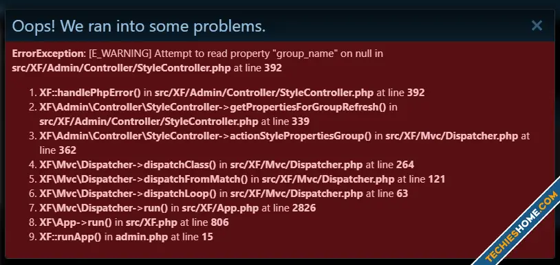

hy admin i have face a error with this addon when
i install this addon and there is no
if ($group && $group->group_id === 'xentrReputation')
$template = 'xentr_reputation_macros';
group like that and no template so can you give me solution please in xenforo 2.3.6
i mannully try to find it but its not exitst.

here is the log
#0 src/XF/Admin/Controller/StyleController.php(392): XF::handlePhpError(2, '[E_WARNING] Att...', '/home/indtech/...', 392)
#1 src/XF/Admin/Controller/StyleController.php(339): XF\Admin\Controller\StyleController->getPropertiesForGroupRefresh(Object(XF\Entity\Style), NULL)
#2 src/XF/Mvc/Dispatcher.php(362): XF\Admin\Controller\StyleController->actionStylePropertiesGroup(Object(XF\Mvc\ParameterBag))
#3 src/XF/Mvc/Dispatcher.php(264): XF\Mvc\Dispatcher->dispatchClass('XF:Style', 'StyleProperties...', Object(XF\Mvc\RouteMatch), Object(XF\Admin\Controller\StyleController), NULL)
#4 src/XF/Mvc/Dispatcher.php(121): XF\Mvc\Dispatcher->dispatchFromMatch(Object(XF\Mvc\RouteMatch), Object(XF\Admin\Controller\StyleController), NULL)
#5 src/XF/Mvc/Dispatcher.php(63): XF\Mvc\Dispatcher->dispatchLoop(Object(XF\Mvc\RouteMatch))
#6 src/XF/App.php(2826): XF\Mvc\Dispatcher->run()
#7 src/XF.php(806): XF\App->run()
#8 admin.php(15): XF::runApp('XF\\Admin\\App')
#9 {main}

here is the log
#9 {main}

its make a Ungrouped properties when i save its give error and according this addon's marcorender.php says no template exist.
still i use now re download this addon and install it its not working on xenforo v2.3.6
its make a Ungrouped properties when i save its give error and according this addon's marxorender.php says no template exist.

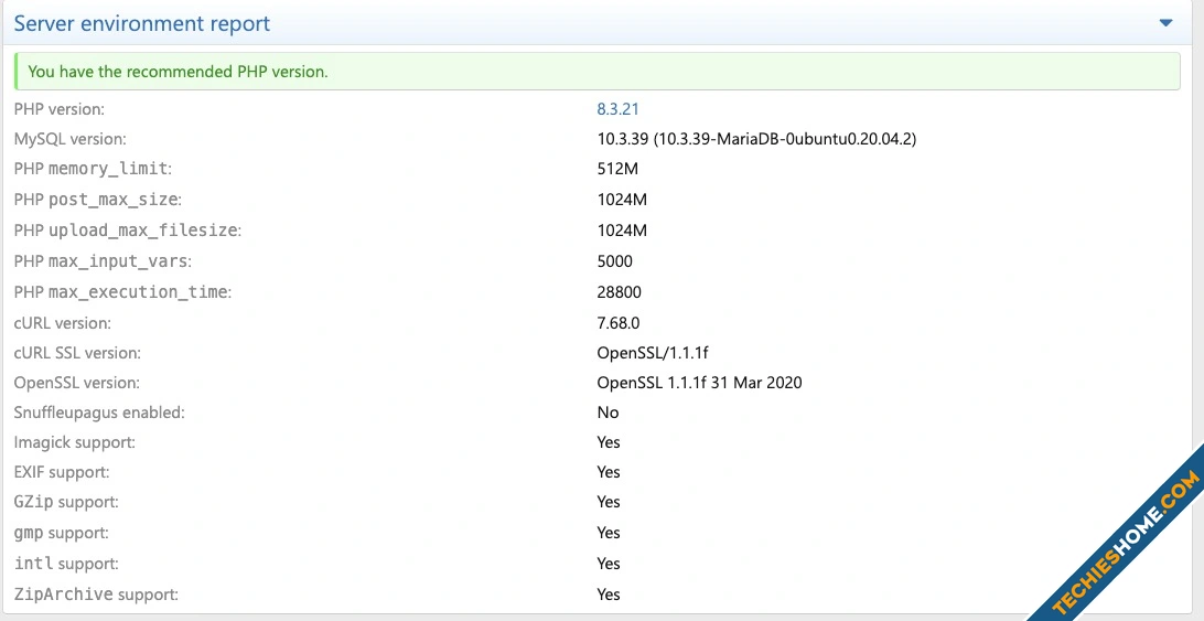

Check this out, and it's on 2.3.7 with PHP 8.3
@indtech FYI, there is no such error with this addon. I just tested it and everything is working perfectly.
Here is my tested server env

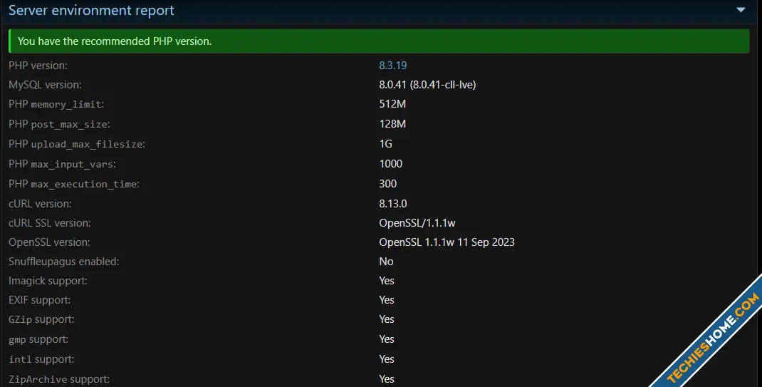

here is my server environment here and the php version i shere its addon file inside code and i'm also using php v2.3.7

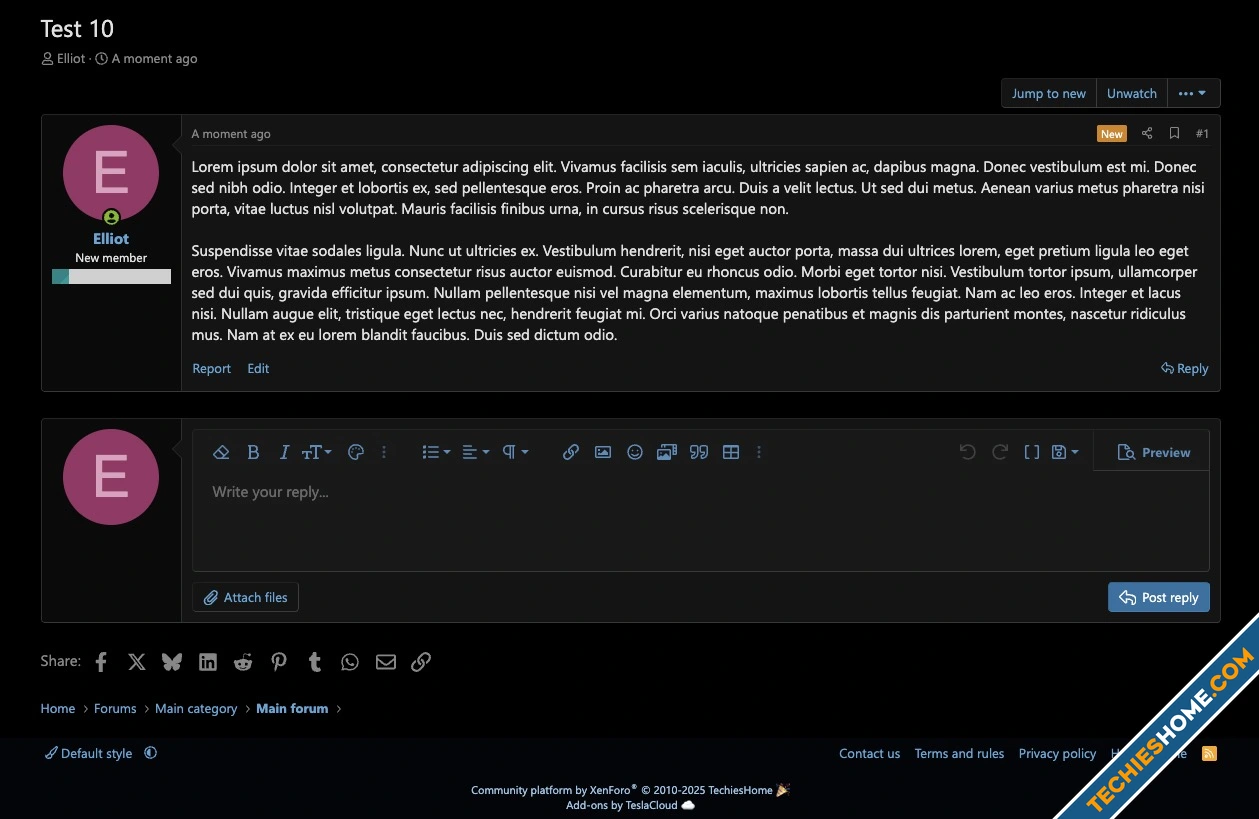

@indtech bro, from the beginning, you posted the wrong error log that was not relevant to this addon.
After you sent me the credentials, I just logged in to your site and saw the addon is already installed, and there is no error log regarding this addon in your server log.
So, I just checked the UserGroup permission if it's set or not, and found you didn't even set the permission to any group to view the reputation bar.
I allowed the permission, and you can see the reputation bar now.
